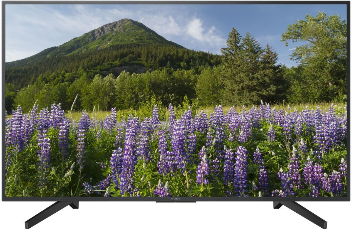

Thats quite a difference the KD-55XF7003 is a 55 inch TV from 2018 and the KD-43K7000E is a 43 inch TV from 2017 and is outwith Sonys update loop. Apart from the physical size the 55 inch set has two feet on the left and right side of the TV and the 43 inch model has a central stand, which does your TV have.
It would be very unusual for a new larger model of TV to be self identifying as an older smaller model.
Are you able to share a picture of the TV and then perhaps a picture of the Customer Support screen
with the model number.
Have you checked the label on the back of the television.
Below are images of the two different TVs, the KD-437000E is first with the sunset, the KD-55XF7003
is the lower image with the mountain scene, which one is your TV.
Click on the link below to get access to the update for your the KD-55XF7003,
The KD-55XF7003 is listed under View All Applicable Models.
Read and follow the instructions carefully.

That really is very strange and something that only Sony could give an answer to.
The TV is clearly the KD-55XF7003 as the label on the back confirms and the position of the legs/ stand.
You could try a factory reset and see if that clears the issue, or go ahead with the update and see if that
resolves the issue.
Did you buy this TV new and has it ever been repaired. I had a smaller version of your TV the KD43XF7073 and it had to have its mainboard replaced (apparently a common fault in these models) and I was wondering if your TV had a similar repair they may have input the wrong ID when putting the TV back together.

Hi @Claire75 It is difficult to scale a photograph, so could you measure the diagonal. It looks like 43” to me and not 55”. I would tend to believe what is displayed on the screen and not what’s on the label.
Just in case you are not familiar with the Sony model numbering, the 43/55 is the diagonal distance in inches.
Where did you buy it from new?
