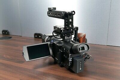

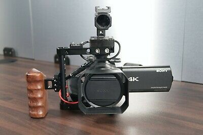

Hi @240ian,
I had both my FDR-AX100 (sold it a few weeks ago) and my FDR-AX100 in a camera cage usually meant for DSLR cameras.
That way the structure is supported by a base plate beneath the camcorders quarter inch thread, which means the top handle doesn't "rip" out of the camera (at least for me it didn't in 3 years of use).
Since I recently sold it I have some nice pictures of my former AX100, yet the cage is the same on my AX700 (just one part is turned 180 degrees.
I used the following parts from the brand "Camvate":
Cage: https://www.amazon.de/gp/aw/d/B06XDHMT33
Side grip (the one included with the cage is not very good and has "play"): https://www.amazon.de/gp/aw/d/B074V4JCYL
Adapter for the MI-Shoe: https://www.amazon.de/gp/aw/d/B00PE3XOZQ
I also have a video somewhere on my NAS which I never uploaded, where I unbox the parts and install them on my AX700 - if you are interested I could render+upload it.
