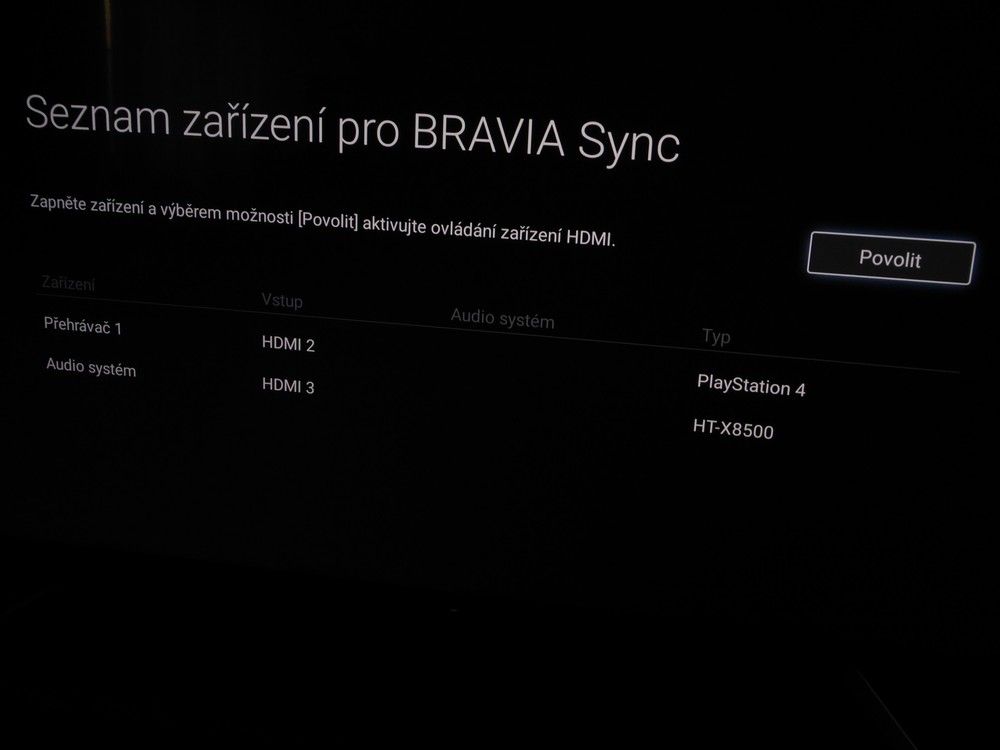

I have TV (KD-55XF7596) and soundbar (HT-X8500), both are made by Sony, TV have latest (6.6520) firmware installed and HDMI ARC connection doesn't work reliably.
When ARC works, list of devices for Bravia Sync looks like this (both connected devices are identified):

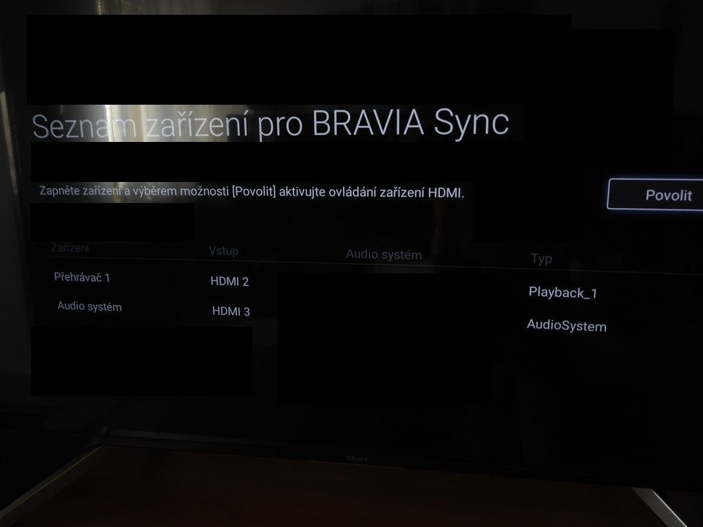

When ARC doesn't work, list looks like this (type changed to Playback_1 and AudioSystem):
It's completely random, you turn on the TV one day and ARC works, another day not, same thing with restarts. Forward this to someone who works on firmware. Or can you advice on where should I post this feedback?

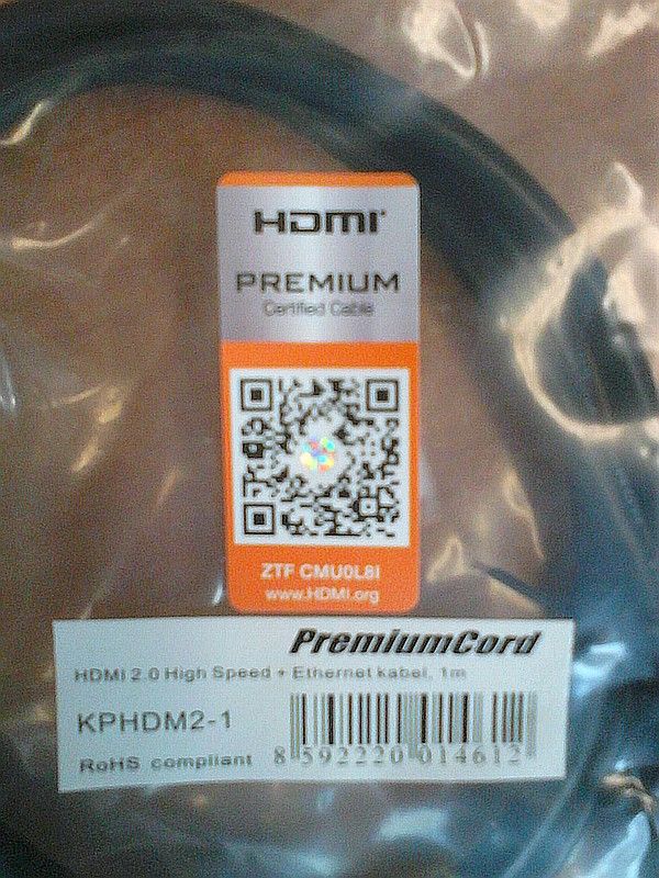

I'm pretty sure that cables had the orange label on packaging, but ok I try another one.
profile.country.CZ.title
novcze
Explorateur
I've checked my HDMI cables and they have certification, no need to buy another one.
