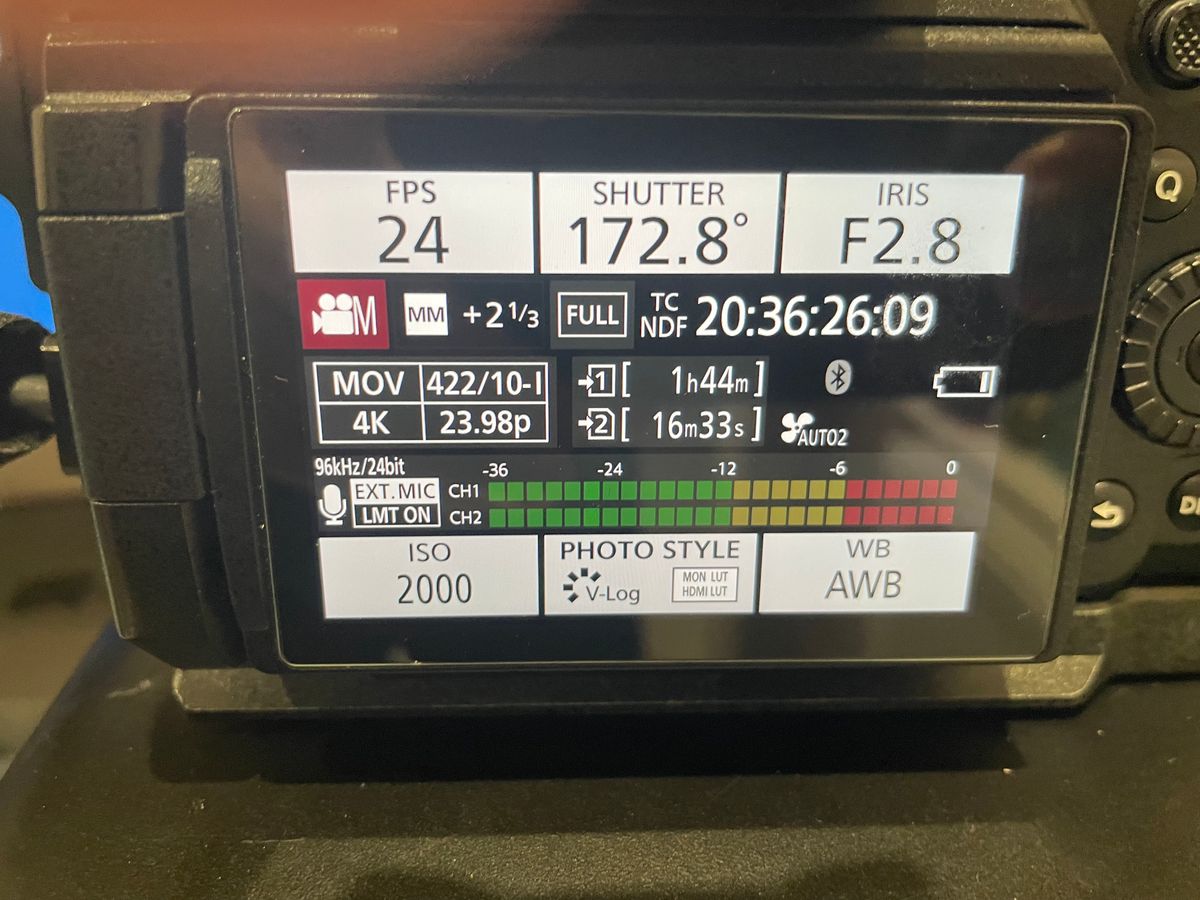

1. I am recording the video I do not want the settings on the screen. I want the settings on the LCD without the image that I do not need as I have it on the monitor.
This is an example from my panasonic camera.
The recorder has a clean HDMI signal no settings. The LCD has all the settings and with the touch i can change them without navigating the menu.
The A1 has a similar screen called viewfinder view in photo mode but this is not available in movie mode. I do not need to see the entire image on the LCD as I have it on the monitor I only need the settings to show so I can change them without pressing buttons
